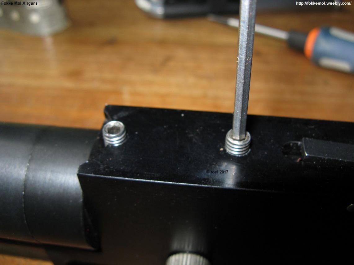

I had to take the Puncher Pro apart for another reason. I wanna show the pics of doing that on your forum. It`s a shame every gun owner doesn`t take his gun apart. The Woild Wide Web would be of more information when everybody wuld take their gun apart.
I`m taking the gun apart. First thing to do is taking the fill pipe off of the action. You don`t need to take the pressure off of it. Removing two Allen screws is enuff.
