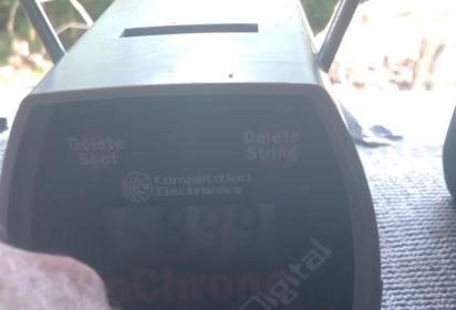

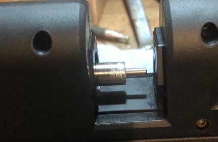

I am still fine tuning the probe for length but so far I have gotten excellent results with an increase in speed on a 150gr bullet of 39fps. It was certainly not easy as none of the “experts” would comment and one even insisted that he had tried it and lost speed. The biggest two issues are ensuring that the probe is long enough that the bullet completely cleared the transfer port on the barrel and ensuring that it did not catch when inserting the magazine into the rifle. I used a 1/8” probe and used epoxy to secure it in the cut off and drilled bolt face.
As I finalize the modification and tweak it I will post more photos as well as a tutorial on what needs to happen for a successful probe to be installed.

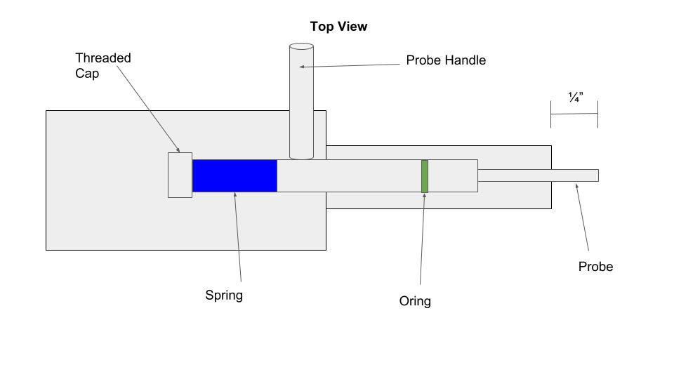

Working on a retractable probe design now that should give more airflow.

The retractable probe will be very difficult to bring to fruition. The bolt itself isn't very long so adding internal pieces without getting in the way of existing pins will be quite the challenge. I have not given up yet though. Got a couple other builds out front of it though now so may take awhile! I am at 944 FPS with 150gr slugs at the moment so am quite happy with that!!
