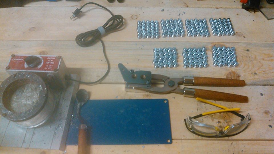

First Picture is of 175 cast bullets, I inspected 125 measured about 25 random ones, size was between .4985 and .5015, next I took the remaining 50 bullets and weighed them in groups of 10, they averaged 217.9 grains.

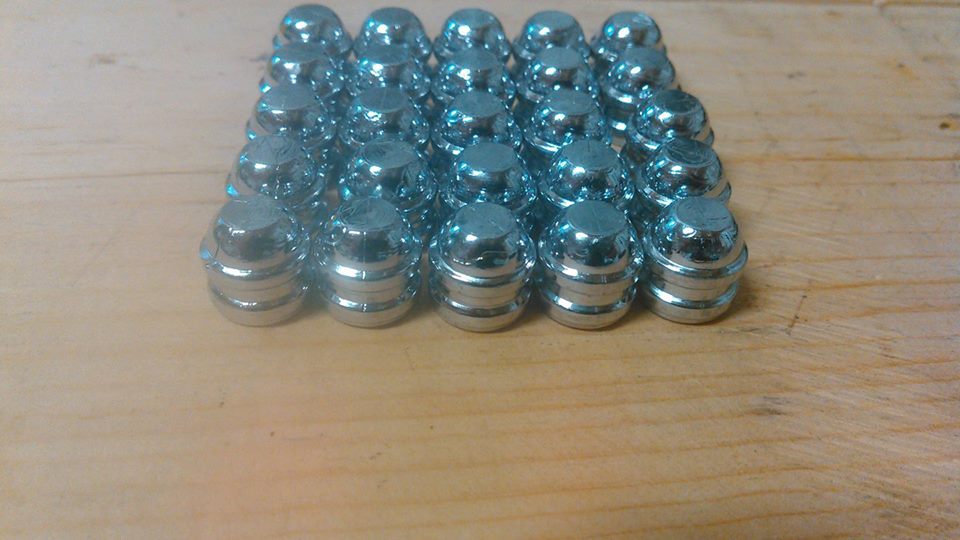

Second Picture is 25 of the 50 I weighed.

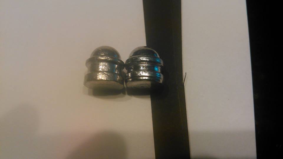

Third Picture is of the purchased round on the left and cast round on the right.
